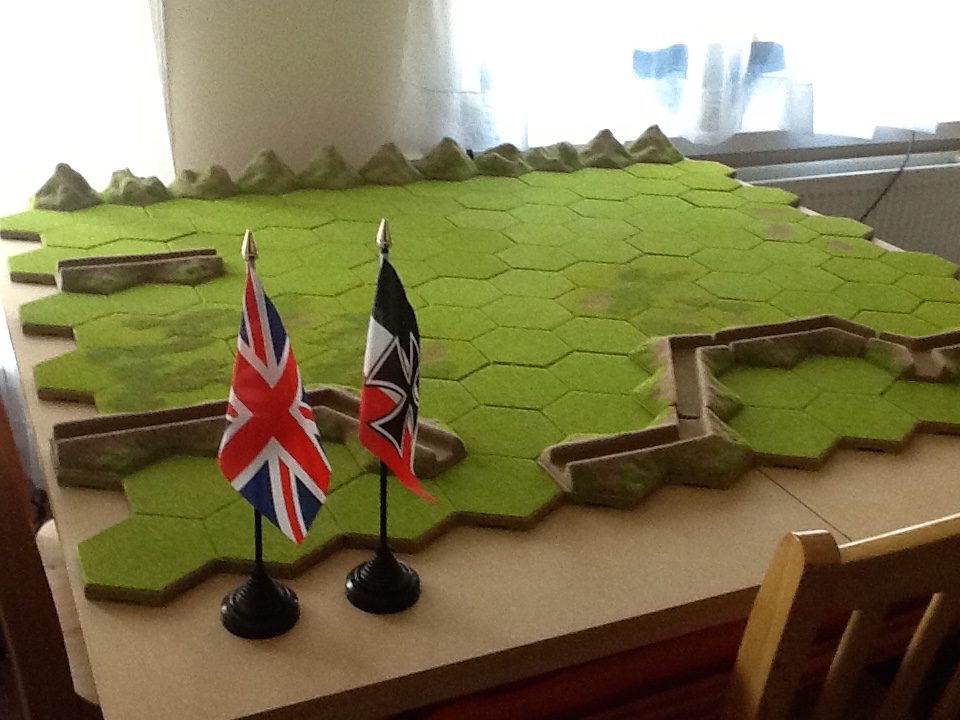

The Great War board game by PSC and Richard Borg looks like is shipping this week probably - all I know its in the Esdevium distributor cat for this week! So I thought I would drop a post on whats needed to build the board using kallistra.
OK the board is 12 hexes by 11 hexes deep. Firstly on the positive side, this means if you set this up using kallistra it fits very nicely on a four feet square table. However in terms of kallistra boards and single hexes is a little more tricky than setting up Memoir 44.
For this set up you need the following in 5 steps:
(1) 5 Hexon boards + 5 Singles
(2) 5 Hexon boards + 4 Singles
(3) 5 Hexon boards + 5 Singles
(4) 11 Singles
(5) 12 Singles
So the totals are 15 Hexon II boards and 37 Singles! I think thats it unless anybody can improve it!
In my photo below I have used 5 more kallistra boards and 4 singles instead of (4) and (5) - but then crossed out the last line with impassable mountains.

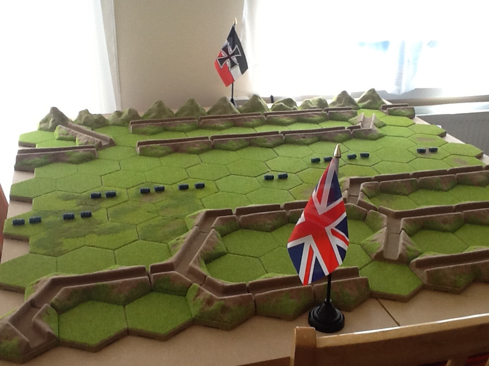

The trenches arrived - many thanks. Here is a picture of the trenches set up on the kallistra board - no particular scenario.
Re: Using Kallistra for "The Great War" board game
looking good there Graham what are the little blocks in no mans land?
Hi Dane
The little blocks in no mans land are Memoir 44 barbed wire pieces. I have seen some nice barbed wire models in the "Raging Empires" 1914 draft catalogue but I don't know how they are made or where to get them from?

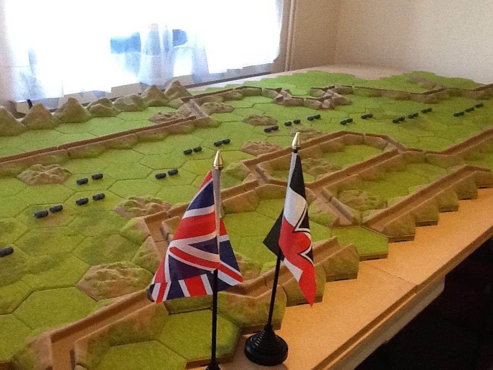

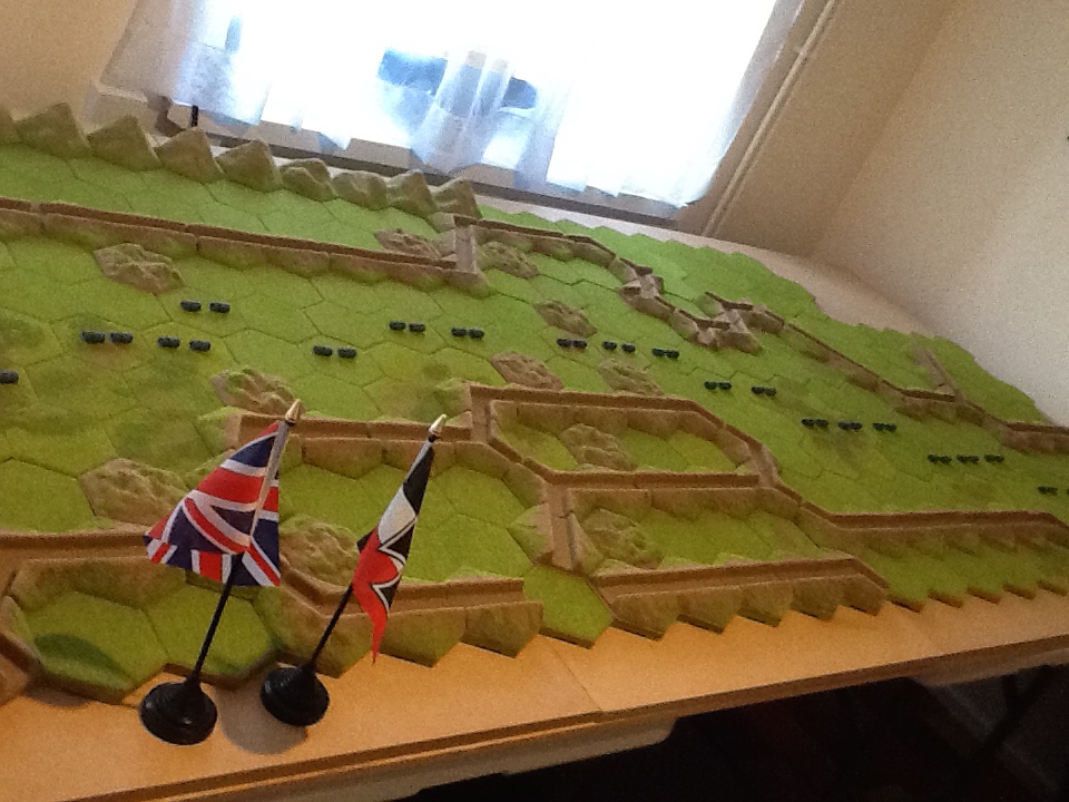

I have built an "overlord" board out of kallistra - see photos below. (If you set up the single board as I described in the thread above then to make it an "overlord board" you just add 4 x 6 = 24 kallistra hexon II boards and ignore the last row.)
Hope you enjoy my pictures.
