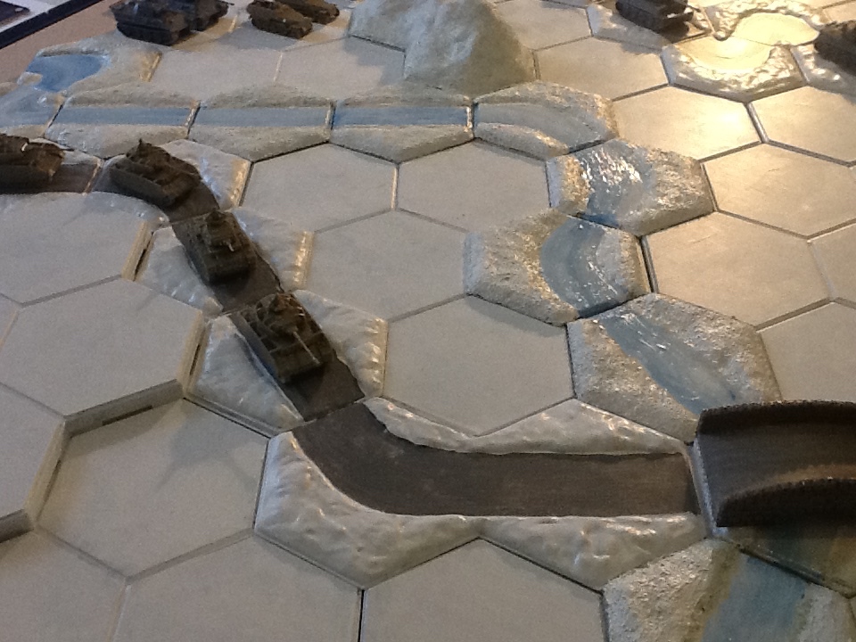

In the last couple of days, I have purchased vallejo water texture and applied it with a brush to my frozen rivers. It is a white, fairly thin acrylic gel that goes clear when dry. It says it can be shaped on the jar but I did not find doing that easy.
The tiles I applied it to were kallistra's green flocked river tiles - I painted them white and a streaky blue colour a week or so ago. The flocking did absorb some of the white paint but a couple of coats covered them.
I find the result of adding the water texture to the painted tiles pleasing, it has given them a bit of shine and sparkle. (Photos attached.)
