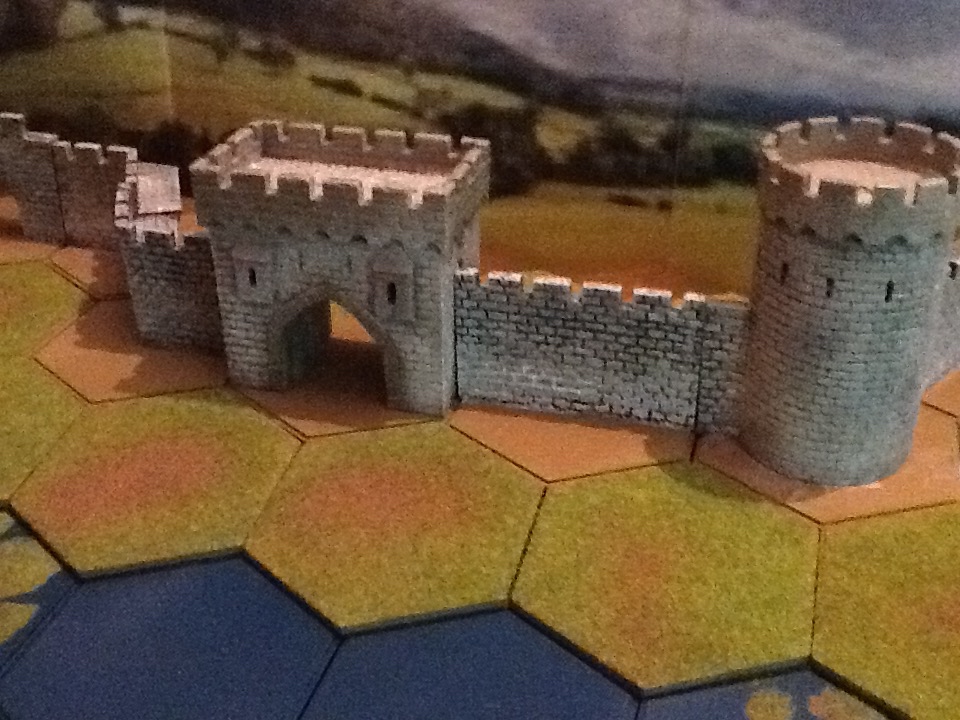

I have just dry brushed my castle - not that difficult - just using a dry brush and paint sparingly.
It has made the colour of all the walls more consistent - great tip Sally!
Attached are some pictures - enjoy!
Dry brushed castle wall
Dry brushed gate house
